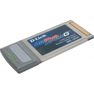

D-Link DWL-G650
DWL-G650 D-Link DWL-G650
